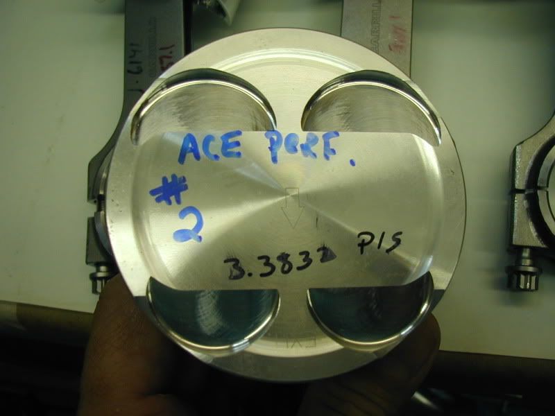

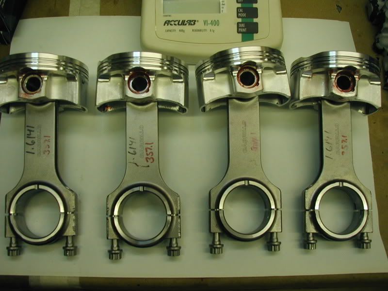

86mm Custom JE Pistons on Carrillo Connection Rods. All balanced within 0.1g
86mm Custom JE Pistons close-up before prep

Rod #1 & 2 big ends altered to balance or clearance? # 2 looks like it got hot.

lets see what was done to the pistons???

Chavcat: Sal's going to have to answer that one, he's got all the details on the build... I'm just the messenger.
KZScott: I can only assume it received the standard prep. Balancing, lightening, smoothing of sharp edges to avoid hot spots, etc.... S.O.P. for any piston, but you know all this stuff like the back of your hand. You just like pulling my leg and watching me squirm!!! hahaha

haha yeah :D, real question, are the rods stock length?

We only needed to make a small change to rod #1 for clearance of the basket
Stock length rods !
Every piston was massaged accordingly then balanced within 1/10 of a gram !
