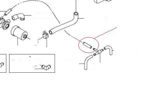

I've checked all connections, seems to be good. All I can think of is what I have changed. A few years back I took out the Kleen air system. When I did that I put silicon in the end of the central vac line like here. [IMG][/IMG]

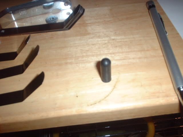

the only thing i did different is cap it off with this. Because I could blow air through the original tube that had dried silicon in the end of it. [IMG][/IMG]
I also saw a little machined hole in the frame, up close to where the steering column is. I filled that with a little JB weld putty. Thanks for all your input guys, I was just wondering that was/is the correct procedure for capping the vac lines after the removal.

Rubber cork. Golf tees. Wine corks. Rubber over boot like your photo. The idea behind plugging is to know the engine needs to vent as does the tank. Everything else, close it down, meaning, not to much more needs to vent to atmosphere.

Ive had muzzy block off plates for a while now. I siliconed the end of the vacuum line when I got the plates. I checked it and I could blow through the hose.... It had a tiny hole, so it was probably never sealed. I replaced the line with the pvc cap on the above photo.
