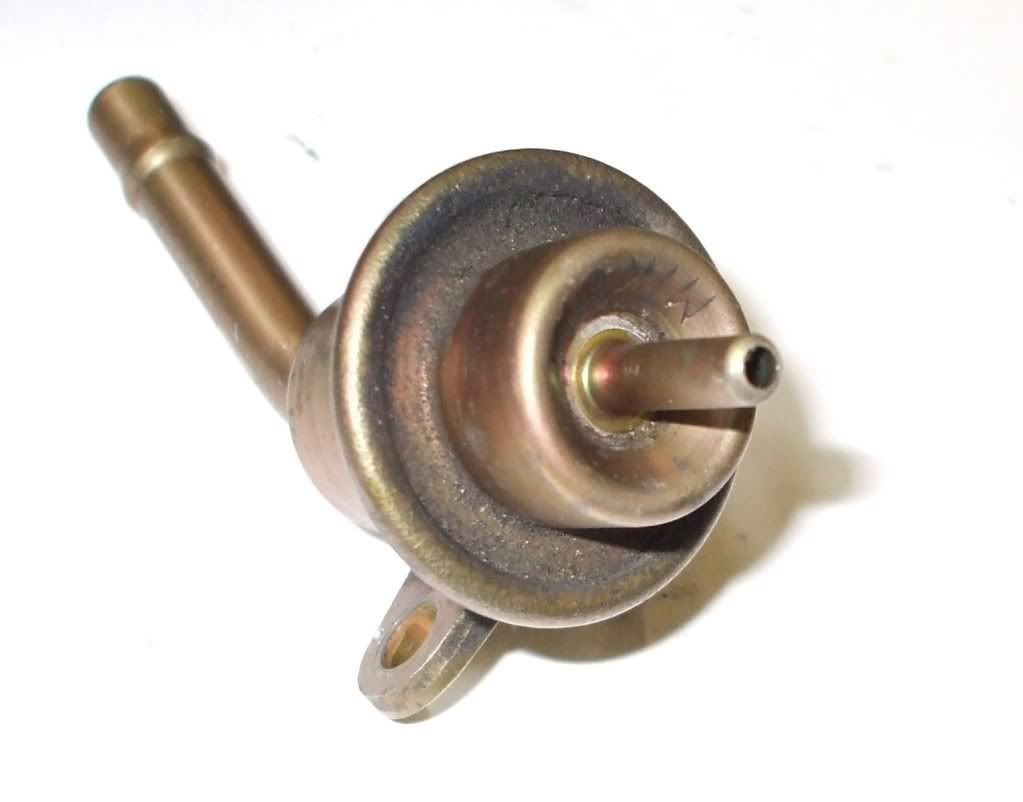

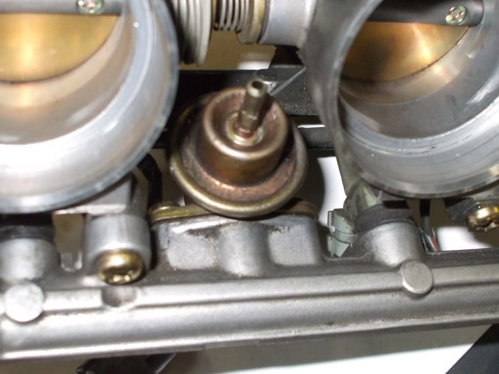

What I did was crush the FPR (fuel pressure regulator) in a vice. this is just like shimming the spring internally making the FPR open at a higher pressure. my most accurate pressure gauge in the range required was on my air pig. I put a few fittings, and an on off valve together and connected that to the fuel rail on the pressure side then turned it on. sure enough air stopped flowing out the FPR at just over 40 psi(stock is supposed to be 41). now the tricky part. take the fpr off and find a way to crush it without damaging it. i cut a piece of pipe to fit, and used a socket to do the crushing part
my goal, 60 psi. but if i go over, up to about 70 is fine from what I have been told/read. (Wolf Racing from Australia and Bear Racing from S Africa).
the first crush showed 48 psi when i put it all back together. this was good, but not as high as I wanted
the second crush looked like this, and THIS IS TOO FAR.
125psi and it wouldnt open. this is why you must be very careful!
I got really lucky and was able to pull it back out a tiny bit with a set of small vise grips. its not pretty, but it will work, and now I have 64psi
this should make the stock 330cc injectors flow like a set of 412cc injectors at normal pressure.

Do you got a website????
Also do you have to pull the motor to get to the regulator or can it be obtined with the motor still on the bike?
I just googled it. B&M Commandoflo #46057...But I got mine at Discount Auto.....Very popular item and takes about 20 min`s to install.....
